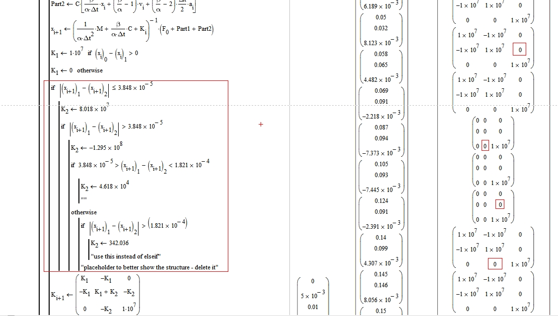

Hi everyone, I don't know what's happening to me, but when I think I know how Mathcad works, I'm not able to do a simple thing.
Mi problem today it's that I'm trying to do an "else if" statement but again, for some reason I cannot figure out how to program it. I've searched through the forum but I don't know how to fill the part that is missing (see image)
Again, if someone could give me a hand with this (I'm going crazy) I would appreciate.
Thx in advance.
Best answer by Werner_E
I didn't spot it the first time:
In the part you highlighted you ask if the x-difference is smaller or equal 3.848*10^-5. Inside this if-branch you then ask if the same difference is greater than that same value, which can never be (otherwise we would not be in that branch).
So your main problem seems to be that you put the follow up if inside the first if while you should have put it underneath.
I tried to correct your program, but its unclear to me what you want K2 to be. You provide 4 different values for K2 but only three different regions for the x-difference: (0..3.8*10-^5] (3.8*10-^5..1.8*10^-4) [1.8*10^-4..+inf)
See attached a possible solution which considers at leaast the three intervals for Delta-x. You have to change it to allow for the fourth value.
BTW, you will have a hard time trying to find a number which fulfills your condition 😉 cond1.png

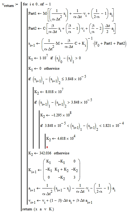

May 1, 2013
Actually I've tried as you said, but as you can see in the image below it's not doing the comparison

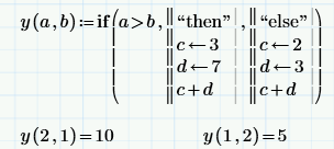

Use please not operator but function if:
April 29, 2013
Why? I see no reason for not using the programming structure.
