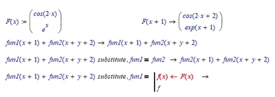

From "Mathcad Prime 7 Symbolic Engine.mcdx" :
I should think that this makes a stronger case:
(Note that this is from Mathcad before version 14, where Maple is the symbolic engine and the default assumption for undefined variables is complex, as demonstrated by:LucMeekes_0-1629875651749.png
If you type this in Prime, without the assumption, and it still produces 0 as an answer, THEN you have demonstrated that the default assumption in Prime is for x to be real.
Likewise:
Further down:
Neat!
(Mathcad 11 doesn't support defining a local function to a program:
Now I wonder if/when Prime supports symbolic assignments in a program, so that there is a chance for building a function that symbolically solves ODE's with constant coefficients...
