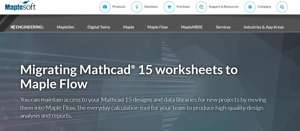

An alternative to MATHCAD 15.
Since it is no longer possible to install MATHCAD 15 on  my new PC, even though I have a perpetual license, I am looking for a software that is up to its standard. I was offered MAPLE FOLW...What do you think?

18-Opal
Nov 7, 2024 9:12 PM UTC
Well according to Maple Flow (Great!)
How Maple Flow Compares to Mathcad® - Maplesoft
According to this forum (??)
How Maple Flow Compares to Mathcad - PTC Community
Nov 8, 2024 8:31 AM UTC
I believe you can use MATHCAD 15 on new PC in case that you are allowed to install virtual machine with appropriate operating system and MATHCAD 15 installation inside this virtual machine.
-MFra-21-Topaz IIAuthor
