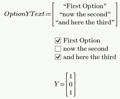

I guess what is confusing me is the apparent MathCAD flexibility of defining variables and functions on scalar, vector, or matrix forms in kind of a seamless way.
What I was hoping for was some kind of way to pass an array of text labels to the Checkbox control, which the control would displayed as shown in your second figure, and get an array of boolean showing which of the labels were checked.
Anyway I will try to work around it.

So your actual goal was to provide the label texts for the checkboxes via a matrix of strings?
Here is a way to do it, even though it may be not that straightforward as it would be desired.

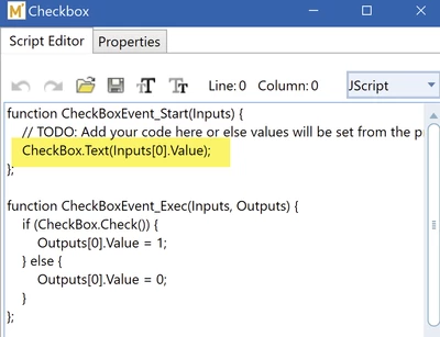

The checkbox script is the same for all

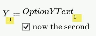

They use an input which is the string to be displayed and are assigned vector elements. So the indices have to be changed individually for each check box:
It would be nice if the number of checkboxes could be controlled by the number of entries in the OptionYText vector, but thats not possible with this approach - you have to create the number of check boxes needed in advance.
Prime 11 sheet attached
