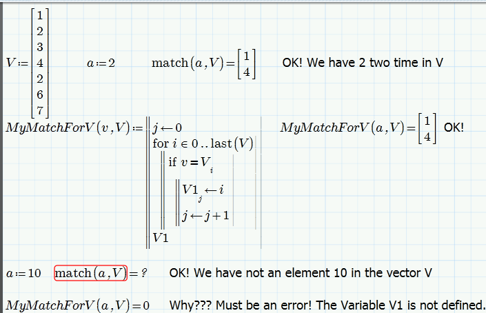

I think it is an error in Mathcad Prime 2.0 and 15 programming:

I disagree, Valery. Implicit local variable creation has long been a feature of Mathcad and changing it would require a rework of most of my worksheets.
In the case of the function you have given in example, I usually use my own variant of match which deliberately does what you've demonstrated so that I can explicity handle the 'no match' situation - it's clearly identified by being a scalar (I have a few programs that return -1 to ensure that the result isn't treated as a valid index into a zero-based array).

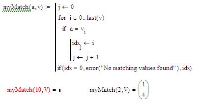

It's simple enough to emulate the match behaviour if you want to:
I'm more scared of the side-effects of introducing a change to this than I am of living with the occasional error ...
