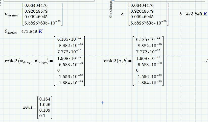

Please check the attached file and change the initial guess value....
I understand a intial guess value is important for a numerical solver....
But for this problem...a deviation of 0.01 from the solution is enough to cause an error while using Find and it only happens in prime 2.0. I think this is telling me to put prime 2.0 in trash!
When solving the exact same system of equation in MC15, the initial guess can practically be any thing....and it always converge with a tolerence of 10^-7
This problem has multiple solution depending on the initial guess. And MC15 can always converge with tiny tolerence and find the corresponding answer. But prime 2.0 cannot!!
BTW, The system of equation is just an exact copy of Harvey Hensley example on a CSTR, which was written in MC15.

I don't know much about Prime so I can only image that you didn't use the same numerical algorithm. In MC15 you would right click the word "find" or "minerr" and usually a good choice is Nonlinear/Levenberg-Marquardt.
I don't know which algorithm Prime defaults to and if and how you can change it there. I remember vaguely reading in the help of Prime that it choses the algorithm automatically. Maybe there is no way to force it to a specific one.
Did you let convert your working Mathcad15 worksheet to Prime format or did you typed it in from scratch?

Try just clicking on Calculate, within the Calculation Tab. The file worked ok for me when I did this! It seems to be the same idiosyncrasy that Valery has come across a couple of times.
Alan

When you say the file worked, are you able to converge using Find? what is the tolerance and error you got?
The results are exactly the same regardless of the offset. See the screenshot for wout:=ans+0.1
