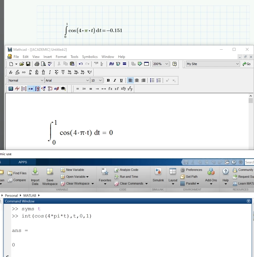

I just got Prime 7 and tried to do a sample calculation for a class.  It doesn't seem to be able to evaluate a very simple integral.  V15 and MATLAB both get the right answer with no problem.   The weird part is that it only gives the wrong answer when the number is 4.  I didn't see a problem with other numbers.  This was for a lesson on Fourier series.
Hopefully, the problem is me and not Prime 7.  I most appreciate any suggestions.

I'm sorry, but the problem is not you, but Prime 7.
Better stick with Prime 6, where it was still OK:
Which means that PTC (again) managed to make things worse.

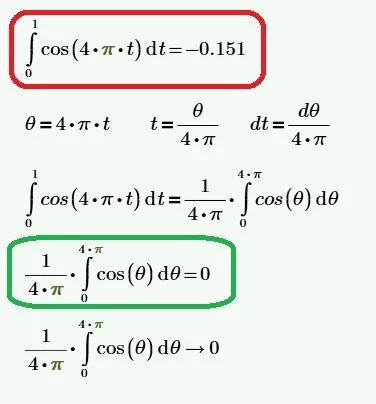

But it does get better in Prime 7 when you split the integral up:
And then it doesn't matter how you split it up:
If you're a licensed user, report this serious bug to PTC.

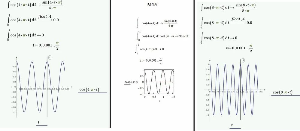

Thanks for the example.  It appears to work as a symbolic calculation in Prime 7, but not a numerical one?

Another oddity:
