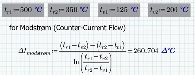

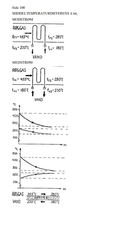

I'm currently working on a project related to heat exchangers, specifically focusing on an economizer. I've attached some temperature characteristic curves showing the temperature profiles for both co-current and counter-current flow arrangements. However, I'm having difficulty adjusting the axes for both the x-axis (distance) and y-axis (temperature) to improve clarity and presentation.

i have added a mathcad prime file and a screenshot from my book,

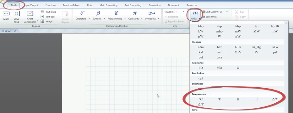

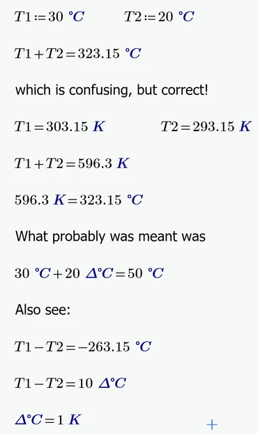

Could it be that you confused "deg" (degree, a unit used to measure angles) and "C" (Coulomb, unit of electric charge) with "°C" (degree Celsius, a  temperature unit) ??
Also note the difference between °C  and Delta°C !!
Concerning the the plots - the functions you plot are linear functions, so (unlesss you use log scale) the graph is a straight line and not what you show from the books screenshots.
