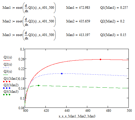

Please see the attached MC 15 worksheet.
I need help in finding:
1- Maximum values of Q1(x), Q2(x) and Q3(x)
2- Asymptote to y(x), z(x) and Z(x) (How can we verify that these curves have horizontal ASYMPTOTES?)
Thank you so much.

ad 1) you could use root and the derivative, as odesolve returns sort of a pseudo-functions (vector of points but implicit interpolation) from which you can take the derivative and use root on it. See attached.
ad 2) you can't. The "functions" you have are only valid for 400<=x<=1000, so you can't explore what happens if x approaches infinity (which would be necessary to prove that a horizontal asymptote exists). The best you can "prove" is that all available values Z(x) are smaller than Z(1000) - thats no prove for a limit of course.
To verify a horizontal asymptote you would need Z(x) in an analytical form, that means you will have to solve the DE manually or with the help of Laplace, if possible. Then you could take the limit x-->inf and see what happens.

Valery, do you really think thats of any help here?

Hello Werner,
Thank you so much for the input. Very helpful.
