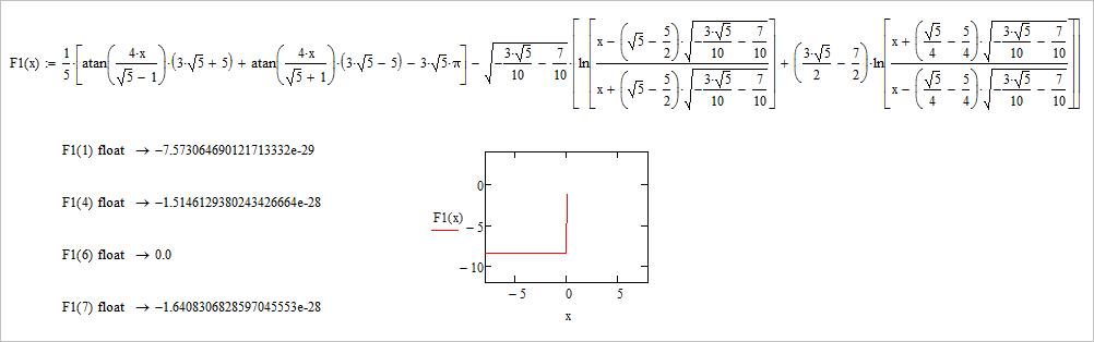

I need help with the graph of the above function.

See please picture and attach
January 20, 2014

Many thanks for your time and help, Valery . I'm really a new with Graph. And I have a related function :
It seems my graph there're some points missing : (1,0) , (4,0) , (6,0) , (7,0) ?
May be it is for this House
http://communities.ptc.com/groups/mathcad-paradoxes
