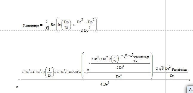

i have a Formula to calculate the elastic plastic transition diameter for autofrettage:
Dp is the elastic plastic diameter. The problem is i need to plement the calculation for DP into microsoft excel.
I need a formula to directly calculate DP. Now im using the solve function in excel but the solver is not trustable and does not give always a result where a result is calculateable.
Is there a way to transform the equation so that DP=..... for microsoft excel?
Transforming gives this block in Mathcad
where RE Yield Stress @20°C
Di inside diameter
Re Outside diameter
lg
Stefan

The function you found using mathcad uses the LambertW() function. Please find out first if Excel knows/supports that function.
The conversion to string should not be difficult. If you save your files as Mathcad 11, I can (try to) convert it to string just like:
But... As said: Your Excel needs to support the LambertW function, and I have my doubts about that...

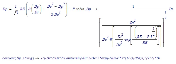

Excel seems not to include a ready made Lambert-W function but if you search the net you'll find a lot of links showing how to implement that function (e.g.: http://bfy.tw/MA2i)
The rest seems to be just a lot of tedious and failure prone typing work but, alas, we know that Excel sure is not the right tool for math and engineering work.
You may also want to simplify the formula first. E.g. Re cancels and does not have any influence. You also can cancel De^2, etc. This sure would make it a bit easier to convert the formula.
February 6, 2019
I don't see Re cancel, You can divide it on P, to make life simpler. But you can do the same with 2/sqrt(3)...
Anyway, I put the equation in Mathcad 11, solved it and converted it to string:
And to save the tedious retyping here is the string:
1/(-Di^2/De^2/LambertW(-Di^2/De^2*exp(-(RE-P*3^(1/2))/RE)))^(1/2)*Di
