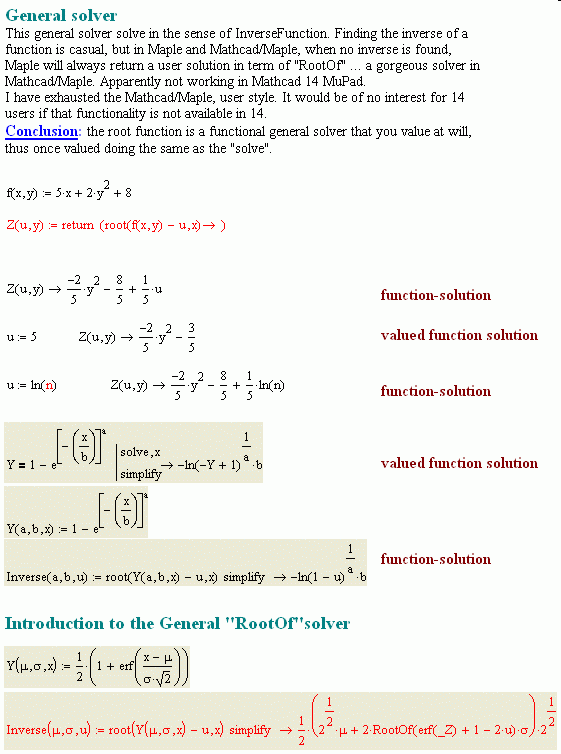

You are using the word "substitution" instead of "assign-define". That's the way it works or known to work. It has to be this way because in general the definition will carry parameters that have nothing to do with the symbolic, like in the DE Laplace solver, thus not losing the generality of the setup.
Your example [if the one catched from Rich] is a non sense. You must realise that if you reinject the solution of one variable vs the other, the back substitution returns the value you have solved for. Mathcad 11 and probably 14 does exactly what you are asking for. You can plug manually, the solved argument. But that is totally useless to plug back the solving argument as it will return the value solved for.
The general case works like it has always been working. A CAS like Mathcad obeys the rules that apply and not any rules that don't apply. The rule you are trying to apply is not a rule.
jmG
April 25, 2010
... I will leave it there as a qs tutorial to use if working directly in 14 or reconstruct and try. Everything should be clear how to handle the solver c/w an introduction to the "RootOf". This should reply completely to your "substitution" but more generally.

You can always try to use the "Symbolic compactor". This example does not compact really because the result is too short. In many instances it does well, like the DE example in black.
jmG

Hi jmG,
The way you described is not working on my mathcad14. The part "return(SOL solve x)" is not yielding the value of "x". So please let me know the possible problem.
And is this the only way we to automate the substitution of symbolic expressions in mathcad?

It works the same in 14 as in 11, but it doesn't do what you asked for. Do it the way Rich showed.

Please see attached. I have not done this much, but the symbolic result is available this way.
Rich
