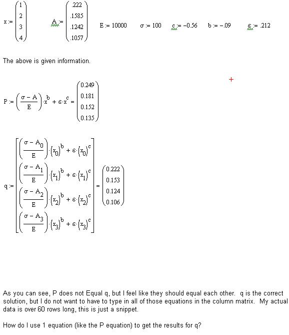

I've attached my worksheet on what I am trying to do.
I have two column matrices, 4 rows each of given data. I need to calculate the third matrix based on the first two with a simple equation, but I can't get it to work the way I want to. See the attached image below:
Any suggestions?
Best answer by ptc-4451268
Vectorize!
ptc-44512681-VisitorAuthorAnswer
March 18, 2012
Vectorize!
