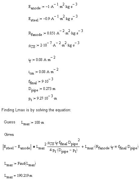

Can anyone help me to understand why the attached mathcad boolean equation will not work?
Your help would be greatly appreciated.
John

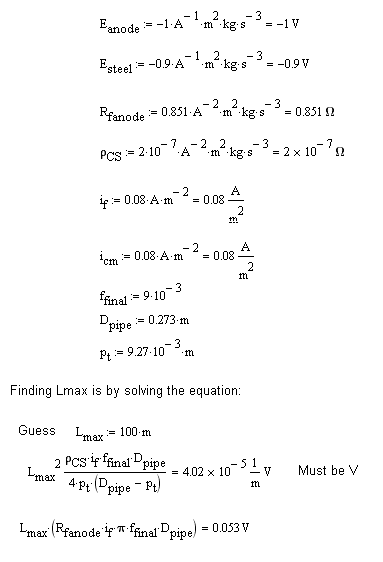

There seems to be a problem with your units.
Mike
December 2, 2011
December 2, 2011
The first term on the RHS of your equation has units V/m, but should have units of V. Should the Dpipe in the numerator be Dpipe^2?
Alan
December 2, 2011
How about the attached?
Mike

Thanks very much Mike that is great. can you tell me where I was going wrong?
John
