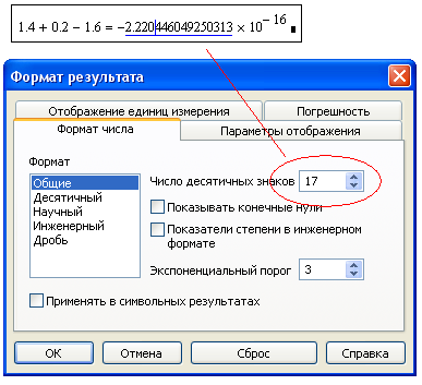

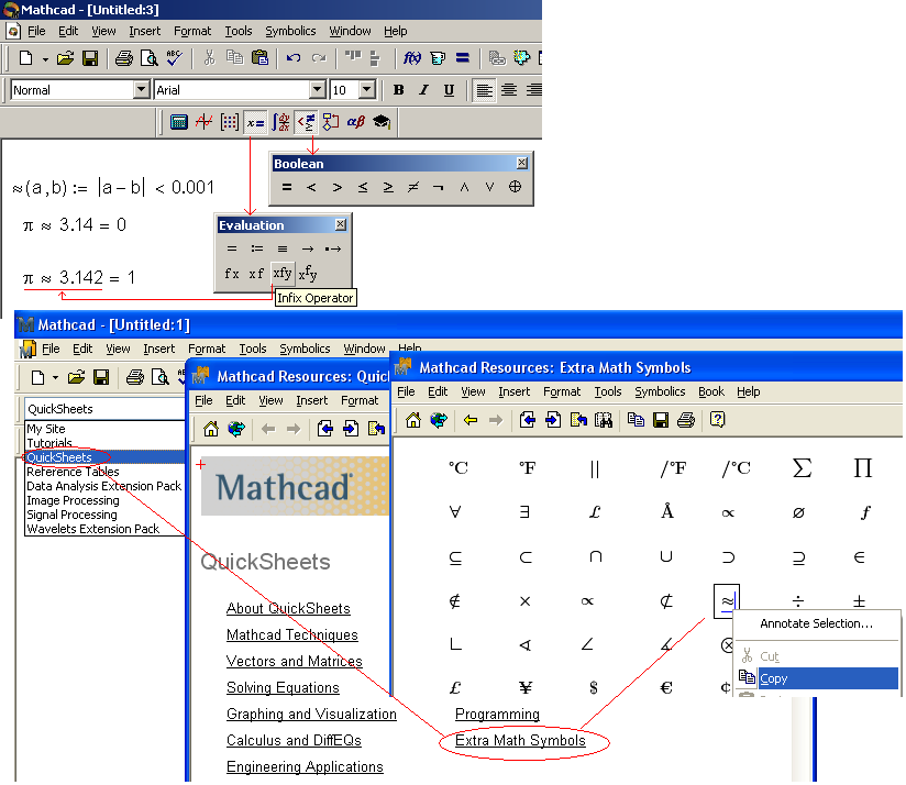

I think it is "a bug". We have same "bug" in Mathcad 15 when we have not 3-16 digits in rezult 1.4+.2-1.6= but 17 digits (maximum).
BUT why "a bug" not a bug!
The first rule by working with floating point (in Fortran, for example) - do not use the "exact equal" operator and use only the "approximately equal" (see the picture). We can use an "exact equal" operator only by working with strings, boolean, intrgers etc variables.
We must always remember it too by working with "smart" Mathcad .

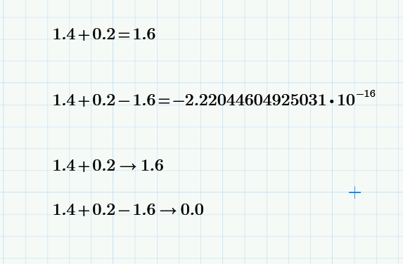

Hello!
Here what result turns out in Mathcad 15 M010 (so, there is no problem with that):
And in Mathcad Prime 1.0 (It is possible to see what numerical value is accepted for "0"):

The difference between Mathcad 15 and earlier versions and Mathcad Prime 1.0, is that Mathcad Prime displays small numbers unlike Mathcad 15.0 which displays small numbers as 0. It's an issue of floating point precision on computers. I am raising this issue with the developers since it came up in another context.
However, if this is evaluated symbolically, it shows the expected result.

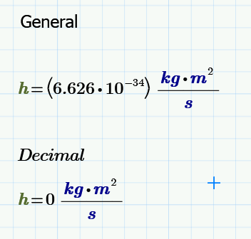

Mathcad Prime 1.0 has double point floating point precision. It's not possible to represent some numbers, due to rounding errors.
If you look at the Formatting tab, you will see that we chose General as the default Result Format, so that small numbers would be displayed, such as Plank's constant:
If you want your small zero's to display as zero, then switch to Decimal in the Result Format, as you see above.

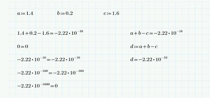

September 3, 2011
See please the picture:
You can change a & b values in attached Mathcad-sheet and see new answer of the a-b operator
PS We have yet discussed this "bug".
