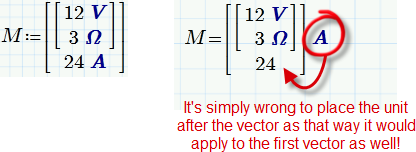

Is the following bug in Prime 2 already known and addressed in Prime 3?
Werner_E25-Diamond IAuthor
August 3, 2013
Seemingly not so I have reported it - Case# C11524852
Hopefully it will be reported as SPR to R&D

Valery Ochkov wrote:
See please http://communities.ptc.com/docs/DOC-2172
Yes, thats an idea for a viable and useful improvement and I wish PTC would adopt it.
But what I reported is, while related, something different. Its a bug. The way Prime displays the unit is simply wrong.

The issue was now reported to Research and Development with SPR 2190245.
...and the bug is fixed in Prime 3 [F000].
