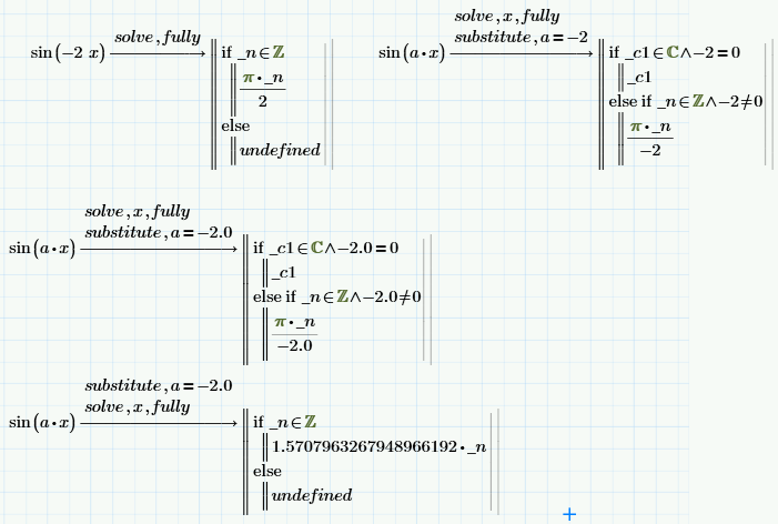

Bug in symbolics in combination with floating point numbers
Did we already discuss that kind of bug here?
And has anybody an idea what the reason for this strange errror (recursive definition) could be?
The error occurs when the frequency is negative and floating point,

Werner_E25-Diamond IAuthor
June 12, 2017
Could have bet on that it would work OK with Maple.
Prime suffers from the same bug (at least version 3.0).

Check if there's a difference in solving sin(2 x), sin(-2 x), sin(2.0 x) and sin(-2.0 x), to see if Mathcad or Mupad handles those functions differently. Or do a series expansion.
June 12, 2017
Positive factors -> no problem. no matter how they are written
neagtive integers written without decimal point -> no problem
But when the factor is negative and is written with a decimal point, whatever I do symbolically with that expression, it will fail with that "recursive definition" error.
I'll try to get hold on a machine with an older release of MC15 or even MC14 to see, if the bug is already present there or was introduced later.

The 0 (zero) answer is too simple, what does 'solve fully' do? ( I don't have that in mathcad 11).

Is this Symbolic Fourier Transform similar?
June 12, 2017
Don't think so. Guess it wasn't a bug there. The OP used a wrong syntax for the "fourier" command and was not aware of the annoying effect that the symbolics switch to its "numeric/float" mode whenever just one number is written with a decimal point.
This auto-float mode could be part of the reason for the bug as expressions are dealt with and are evaluated differently when in float mode. But I see no reason why a recursive definition should be diagnosed just because the symbolics work in float mode.
I vaguely remember a thread dealing with a bug/problem concerning symbolics and floating point numbers. Just can't remember, nor find the thread.
