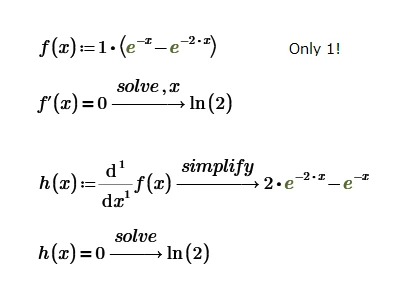

Funny effect and I agree thats it a bug. But it won't help reporting it to PTC as they are not interested, they don't care about us Mathcad/Prime users.
In playing around with your sheet I noticed two things:
1) The bug only occurs if the function name of the derivative consists of more than one character
2) Omitting the "=0" also persuades Prime to return the correct solution:
The bug shows in Prime 4 and in Prime 5, but the bug is not present in Mathcad 15:
Good thing is that there are two easy solutions:
1) If you are lazy, not only omit stating which variable you want Prime to solve for but also omit the " = 0 "
or
2) Always state which variable Prime should solve for - its good habit to do so anyway.
or
Thanks for your detailed answer!
I think I will accustom to always write the variable I want to solve for.
I just do not like such little unpredictable bugs, they could be really bad at an exam.

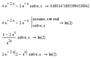

What strikes me most is the fact that the symbolic processor returns 0.69314718055994530942 as an answer, instead of just:
ln(2)
ln(2)
Yes, thats disappointing. Guess Maple in your MC11 does a better job here.
In Mathcad or Prime we have to help MuPad a little bit so that it will come up with the exact result:
No chance, they don't want to (look at the screenshot) ...
