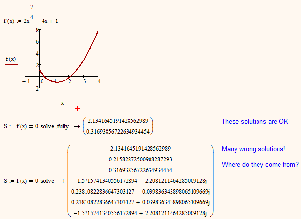

Has anybody an explanation why the symbolic solve produces that many wrong solution if used without the modifer "fully"?
May we call it a bug? Are there other examples?

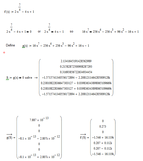

I think it's clear enough where the extra solutions come from; Mathcad must do something like the following on solving the equation.
Alan

Jul 16, 2014 1:30 AM UTC
. Is there something else we might call it?
Because there's a bug
Werner_E25-Diamond IAuthor
Hmm, its PTC - maybe its a feature!? PTC marketing sure can make that possible.
Yes, and obviously "fully" makes the symbolics to think about its results a second time
Alan's explanation make it clear whats happening - false solutions coming from taking the equation to the power of 4.

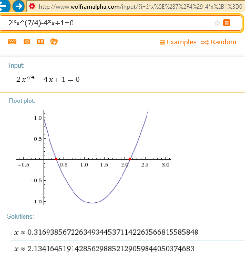

and too few solutions:
Jul 16, 2014 6:13 AM UTC
I use others tools in some cases:
Jul 16, 2014 7:26 AM UTC
Alan
Thank! Yes, at least with your explanation its clear what happens.
Nevertheless a bug which should not happen.
Also intersting the different behaviour when using the fourth root instead.
I know the difference between (-1)^(1/3) and the third root of -1 (only the latter is -1) but not sure about the fourth root and how the symbolics sees it.
