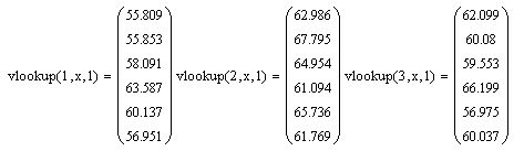

I doubt that is what he's after Richard. If is it it seems a little over the top, could just use the vlookup function.
Mike
