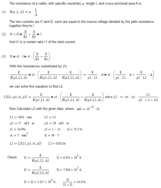

Hi
How would I solve the following problem on cable length
Two cables, both with cross sectional area 5 mm2, are connected in parallel across a common DC voltage of E = 36 V.
The resistivity of Cable 1 is ρ = 17 x 10-9 Ω.m at 20 °C, while the resistivity of Cable 2 is ρ = 28 x 10-9 Ω.m at 20 °C.
Cable 1 is 1641 mm in length.
If 44.9 % of the current passes through Cable 1, determine the length of Cable 2.
Assume the ambient temperature is 20°C.

You can use the current sharing ratio and Ohm's law to determine the relative resistance of the two cables.  They're both the same area.  Resistance is made up of resistivity cross-section area (the same) and length.

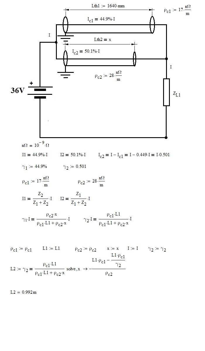

I tend need to disagree.
Note that 44.9% and 50.1% do NOT add up to 100%...You're violating Kirchoff's law.
Also note that the resistivity is (correctly) given in nΩ.m, not in nΩ/m.

The 0.449 and 0.551 is the current split ratio.
All other numbers are self evident from your initial question.
You can spruce it up with a better labels and definitions.

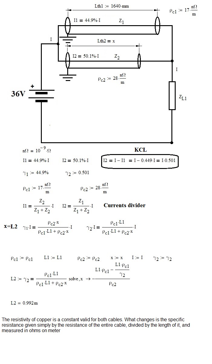

July 22, 2016
There are also a some cheat which can be do with this set of equations.
Actually, the "hide" is only for show the equations, but it not necessary.
Best regards.
Alvaro.

There is also a physical impossibility problem with the way this question is drafted. The cables are NOT "connected in parallel across a common DC voltage of E = 36 V."  They  would have to be connected across a much lesser voltage. While not mentioned in the question the sketch shown in the replies show a Zl1 where most of the voltage would be dropped (which would be a real world connection). If the cables were connected across 36V they would have to carry approximately 2.87 million Amperes. Good luck with that.

Hi. That's what mean a shortciruit. But still have some applications. For example, as lamp, with power about 250 kW for each wire, or to use the wires to cut something by heating them.
Also, a good time to remember that Ohm law isn't a true "law", it is a rule, which sometimes hold, but not always. If the wire explode, them Ohm law don't apply.
Best regards.
Alvaro.

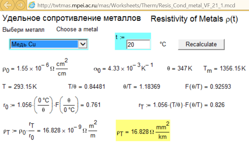

July 22, 2016
A little remark from Mathcad Server - not ohm*m but ohm*m^2/m:
And second - do not use two different metals in one circle
