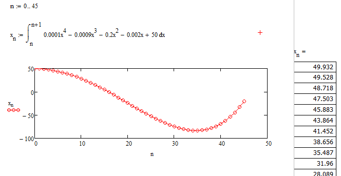

Hi - I'm having trouble here.
I have a function, in which i can calculate the area beneath it. Now i'm asked to 'step-by-step' calculate the area, for 0 to 1, 1 to 2, 2 to 3 (45 times) with this formula:
x and y being the 0 to 1, 1 to 2, 2 to 3 and so on.
But instead of repeating this step 45 times, i would like it to just print 45 answers. I tried something like this without success:
This is just for the first 3 of 45.

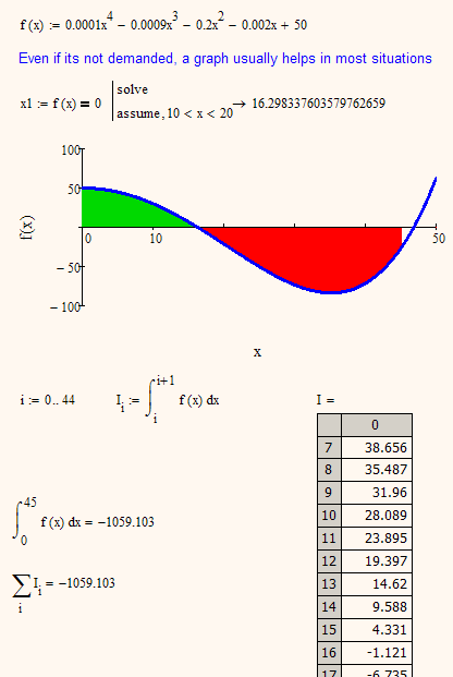

Something like the attached helpful?

Well, that's an option, but again I would need to do it line by line. My brother had a look and this was what i was looking for:
But thanks for the fast reply! 🙂
January 31, 2013
Didn't see that post when I was writing up mine. Pretty much the same (with the difference that your sheet gives you 46 and not 45 values.
Glad you are up and running, anyway

If asking a question it would be beneficial for all if you post a worksheet, too (choose extended editor in the upper right).
It makes it easier to help as one has not to retype the data and/or equations and it helps to detect the version of Mathcad the answer is asked for.
I don't understand why you will use a solve block as Mathcad can calculate integrals out of the box.
Would this help:
