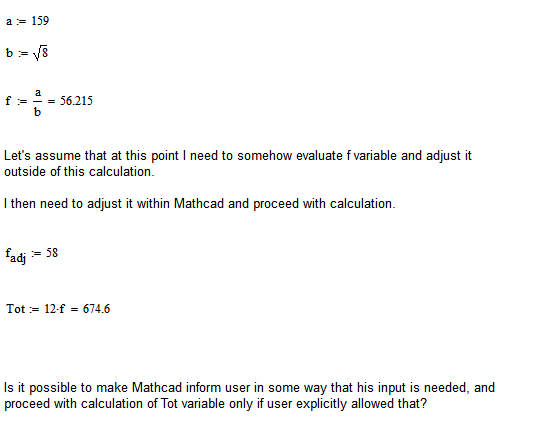

I'm not an experienced user of either Mathcad or this forum, so I apologize if this question is in the wrong place.
Sometimes it's needed to calculate the worksheet with attention to certain breakpoints - for example, some values may need manual adjustments.
Is it possible to make Mathcad stop calculation upon reaching such breakpoints and give user some kind of prompt?
In other words, do not return the final result until all attention points are attended.
I hope I was able to explain this clearly!

Here's the example. It is completely made-up, of course, but illustrates the problem precisely.

Do you always require the user to enter a new value or is there some criteria that determines whether you ask for a new value?

As Mike says, an example of the kind of problem you mean would be helpful.  However, there isn't a general facility for user input into a calculation (such as a pop-up dialog box)

If you are using Mathcad 15 you can use a scripted control. There's an example here: https://community.ptc.com/t5/PTC-Mathcad/Extra-Components-and-Controls/td-p/450450
If you are using Mathcad prime, there's no way to do what you want.

I use red text to notate math areas that require user input.  Until the user manually enters a value, subsequent calculations will indicate an "undefined" error.
When a user opens the calculation template, he/she scrolls through the calculations entering data where notated in red until he/she reached the bottom.
Undefined:
Defined:
