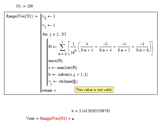

Hello everyone! I have some problem in cycle that I made in mathcd 15. I wrote short code to calculate pi number but only 14 numbers after point I can only see in my array and dont know what to do. Can anyone can help to solve this problem?    @

First: The loop with j as upper limit seems to be a bit useless. At least its not necessary to calculate pi 100 times with increasing precision. Calculate it once with max precision and then do your num2str thing.
The reason for the error is, that you are limited to numerical precison in a program, too.
So no matter how large you choose N1 to be, you will only get a result for pi with approx. 14 or 15 digits.
This result is then  converted to a string with just 16 or 17 entries.
The error is when you demand to take element with indes number j+1 and j+1 is bigger than the last index in the array (max 16).

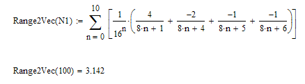

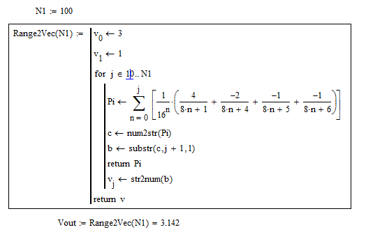

Sorry, but thats nonsense!
You stop the calculation the first time the loop is executed and return an approximated value (the value you would get originally with N1=10) which is completely independend of N1.
What you suggest is exactly the same as
Sure not, what the OP had in mind!

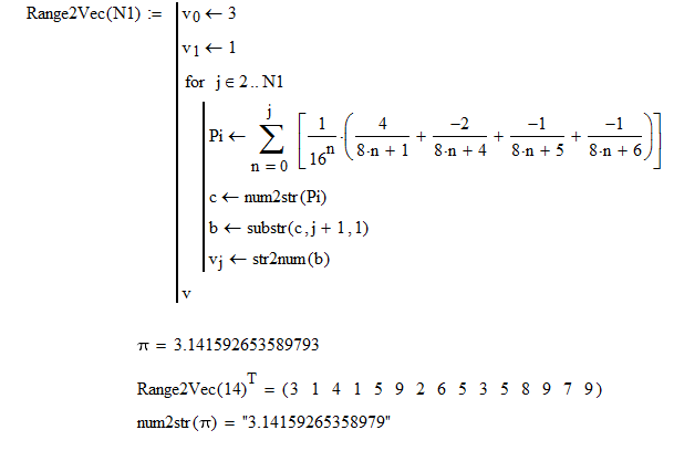

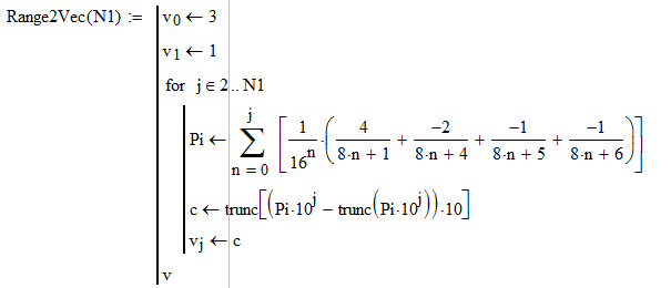

Okay, took some looking:
The num2str function has a limit--it creates a string of only a certain length.  (note num2str(pi) stops at ...79 while pi goes on ...793)
So regardless of how big N1 is, the substr function will fail when it tries to go past the last character in string c.
One fix:
This solves that problem, but it doesn't get you past the basic numerical precision issue.

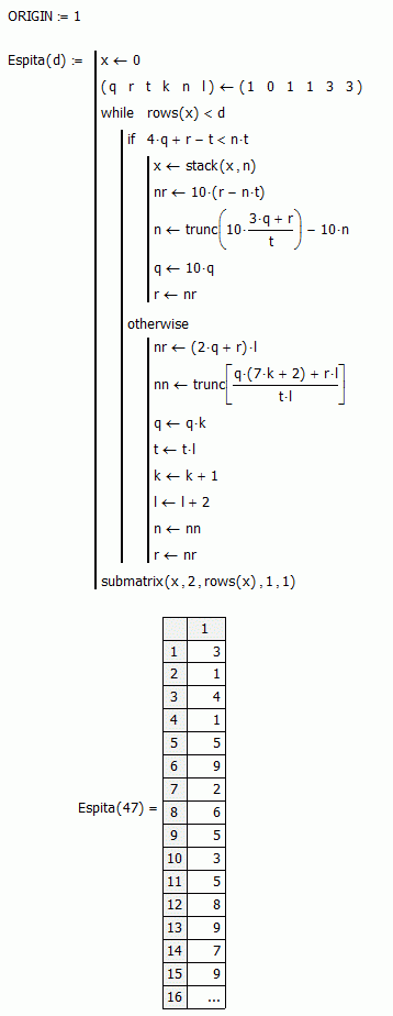

Following is a numerical procedure to get decimals for Pi. But Mathcad, as numerical tool, can get more than 47. If you want more digits, guess must to take them from other software, and read digits from a file. Attached, also first million of pi digits as plain text.
Best regards.
Alvaro.
