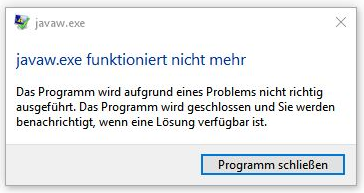

When calling the Help Function in MathCad Prime 3.1 or MathCad Prime 4.0 i get the error Message:
I'm working with Windows 10 and Java is still up to date.
Has anybody an idea?
Thank you
regards, Volker

Now there is a solution found:
The problem was a NVIDEA-Driver.
After uninstalling the driver, Prime-Help works perfectly.

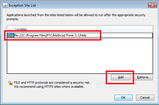

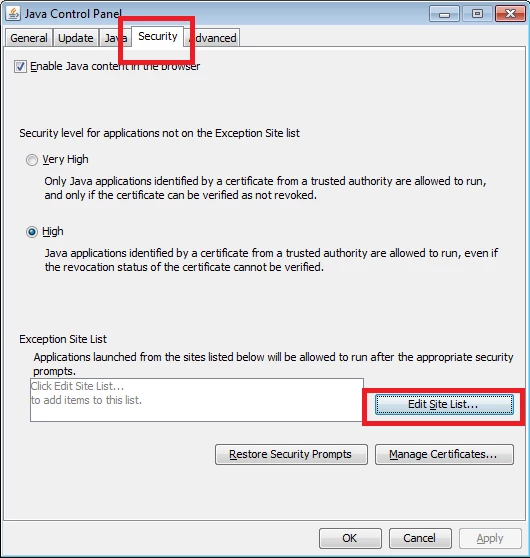

1. Try to edit exception site list in "Java Control Panel" settings (tab "Security") and add the following (need to use forward slashes in the path😞
file:///C:/Program Files/PTC/Mathcad Prime 3.1
file:///C:/Program Files/PTC/Mathcad Prime 3.1/Help
