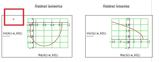

I can not make edit in a worksheet (that was created in version Mathcad 2001i) in Mathcad 15 M020 and also in Mathcad 11. None of the areas (plot/text comment/calculation) are not editable. There are any suggestions?

Richard,
But I can not even click on the plot or text area and just move them aside.
Yes, take a worksheet of your own and the go to "Tools" / "Protect Worksheet..." / "Protection Level: Editing (or content)" and see yourself. This is not to be confused with the protected regions your file includes as well!

It's because the worksheet is protected. It is protected with a password though, so you can't turn off the protection.

Richard,

VladimirN. wrote:
Richard,
