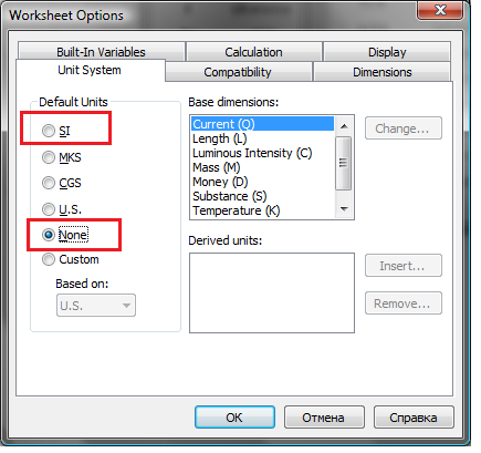

May 5, 2012
Mike,
Here is another solution. In the worksheet unit system set as "None". And when I changed unit system on "SI" (which used by default when you create a new worksheet) then I can copy and paste any text/math region into a new worksheet:
