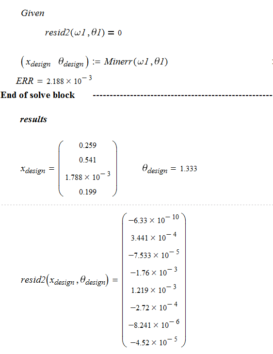

If you only need the best fit then try changing the Find to Minerr.

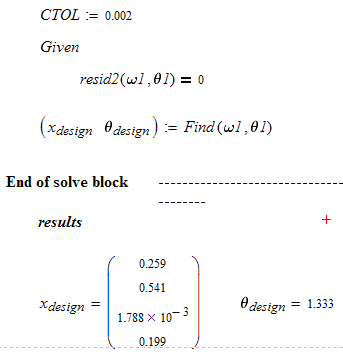

If the question is to test in a newer Mathcad version - In MC15 M020, the current release, the solve block does not converge, too.
If I set CTOL:=0.002 (default is 0.001) I get a solution.

Using the Minerr path , the residuals calculate to distinctly non-zero values, so Find must (nearly) always fail if this is the "best " answer that Mathcad can derive.

This is not my worksheet. It belongs to Harvey and he has been kind enough to help me in the document section. Since I cannot post attachment in document section, I have to post it in discussion. He said I have to pick a new inlet temperature, I think now I understand the worksheet better now.
Besides, I think I found what is the problem too. It is Qm, Qm cannot be picked abituarily only at certain Qm the system would converge. Look at the previous red S shape graph, if Qm is picked such that the slope would change sign while mathcad do its iteration, then mathcad fail to converge. Since the S shape curve can be shifted left and right by tin, changing tin is what is needed if I want to keep Qm to be zero.
