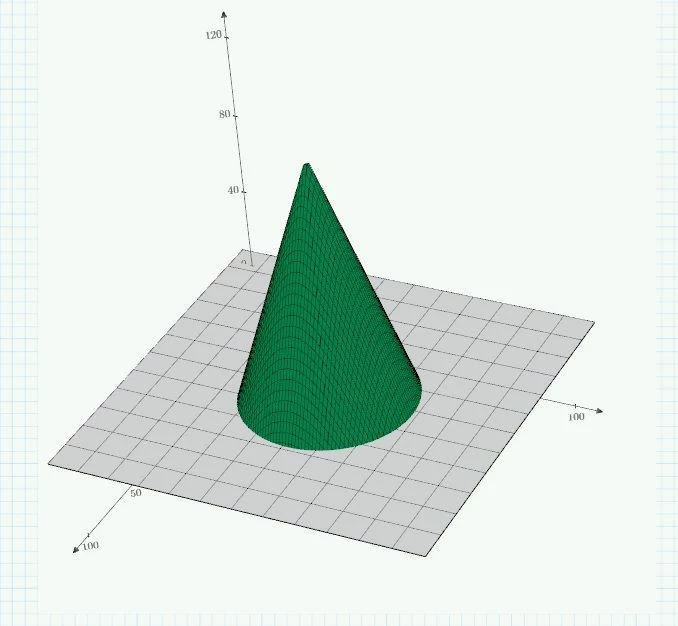

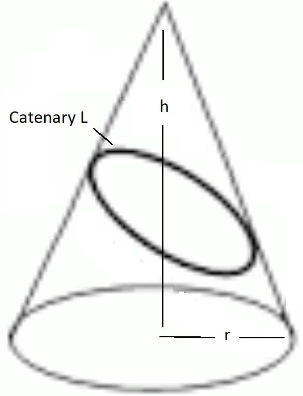

Do you know how a catenary lies on the cone? Without friction!

You should be clearer because the figure shows an ellipsis. It is known to all that the intersection of a plane with a cone is a conic (in this case ellipsis precisely). Therefore I deduce that the catenary is generated by the intersection of a cone and a non-flat surface. the system between the equation of a cone and an unknown surface must give a catenary. Does this surface exist? ......but then, since the catenary is a flat curve, the surface should be a plane, which contradicts the previous deduction.
The cone is ready...........

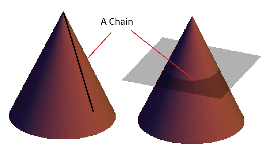

1. Sorry, it is not a catenary (one plane curve), but a chain.
2. Better use a cylindrical system of coordinates
3. This problem has two boundary cases:
- a circle
- a part line

So the problem seems trivial because the circle is given by the intersection of the cone and a plane perpendicular to the axis of the cone, while the chain is the locus of points where the plane is tangent to the cone .....
