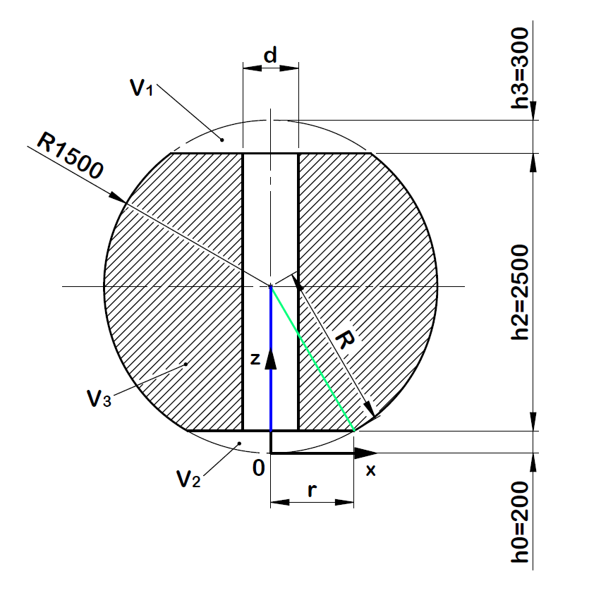

Has somebody an Idea, how to calculate the center of gravity (zs1) in zylindrical koordinates (The boundarys of the 3-Integrals are not really clear for me)?
See attached Files-sheet two of Kugelspeicher.mcdx.

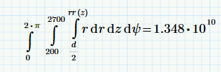

  • The 2 pi is the integral around the angle (full circle.)  There is no dependence of radius (or height) with azimuth, so a true integral with angle is not required.  (That's why there are only two integrals to get volume.)
  • The variable "s" is a variable of integration.  It does not appear outside the integral.  The inner integral above is the integral over the radius.  the limits of integration (for V3) are the radius of the center pipe (d/2) to the outside of the sphere (defined by the function r(z):
  • The outside integral is the vertical integral (z), the limits of integration are the bottom and top of the water.
This is equivalent to your integral above except that the outer bound for radial integral is a function of height "rr(z).
Your integral has height as function of radius; I don't know how to write those functions.

I want to have the integration limits of the Integral concerning to the sketch:
This is a water-reservoir (shaded Area) of whitch i only want to know the integration limits for Integration to get the Volume.

I wanted the correct limits for the Integration of a volume concerning to the upper shown sketch in my origin post.
Yes-It is necessary for finding the center of gravity
