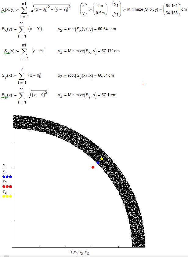

The red point is the geometric median‌.

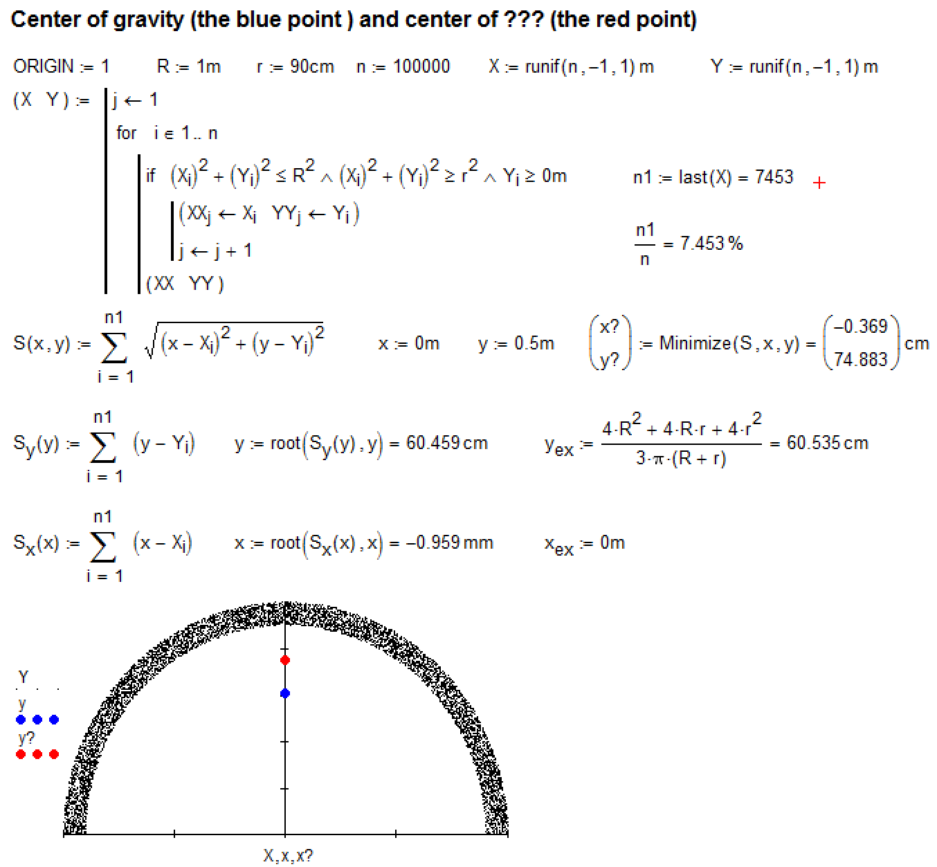

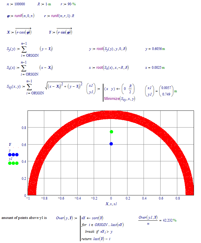

Where did you learn that the center of gravity was y = 0.5?
April 3, 2017
y:=0.5m was just his guess value for the subsequent Minimize function.

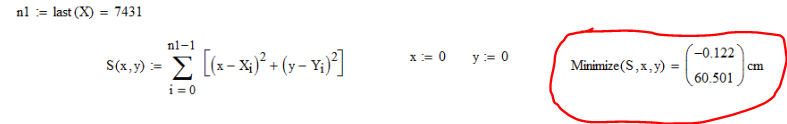

We are all in agreement that the center of mass is at y=61cm.
What is the red point?  As defined by the equation, it is the point with the shortest distance to the mass.  If it has a name, I don't know it.
23-Emerald I
April 3, 2017
Okay, sorry, didn't read carefully.

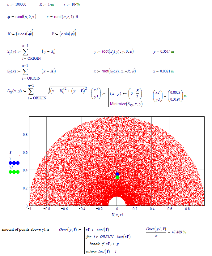

But when I do the same thing:
So I don't see where 74.883 came from.
23-Emerald V
April 3, 2017

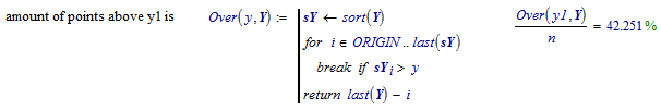

Does this help?

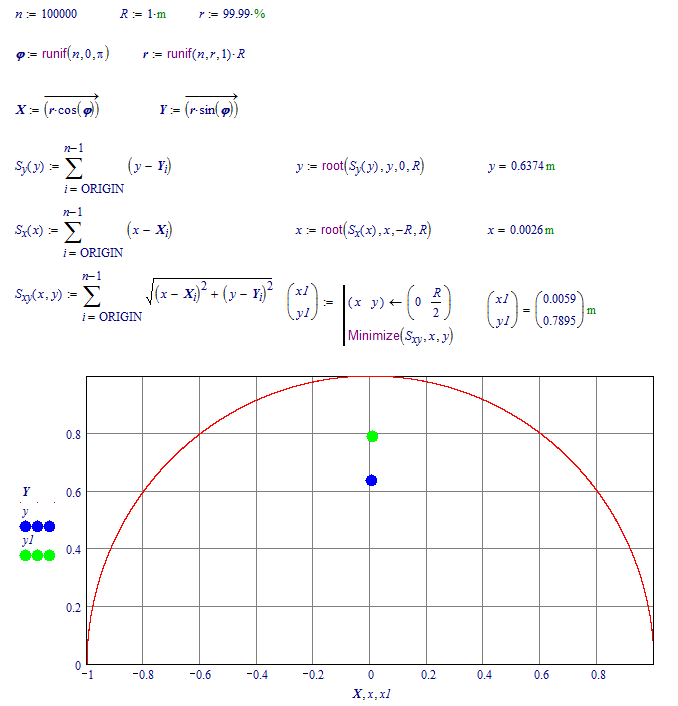

If you change the 'thickness' of the semi-circle, the amount of points with y above y1 doesn't change as much as y1.
Extreme example:
April 3, 2017
Luc,
The way you have defined the data points, there are more near the inside radius than the outside radius.  This is especially visible in your last graph.
Valery's setup made the points uniformly distributed throughout the whole area.
This will skew some of your calculations.

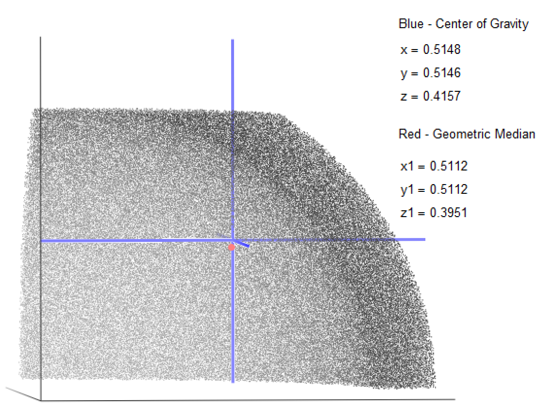

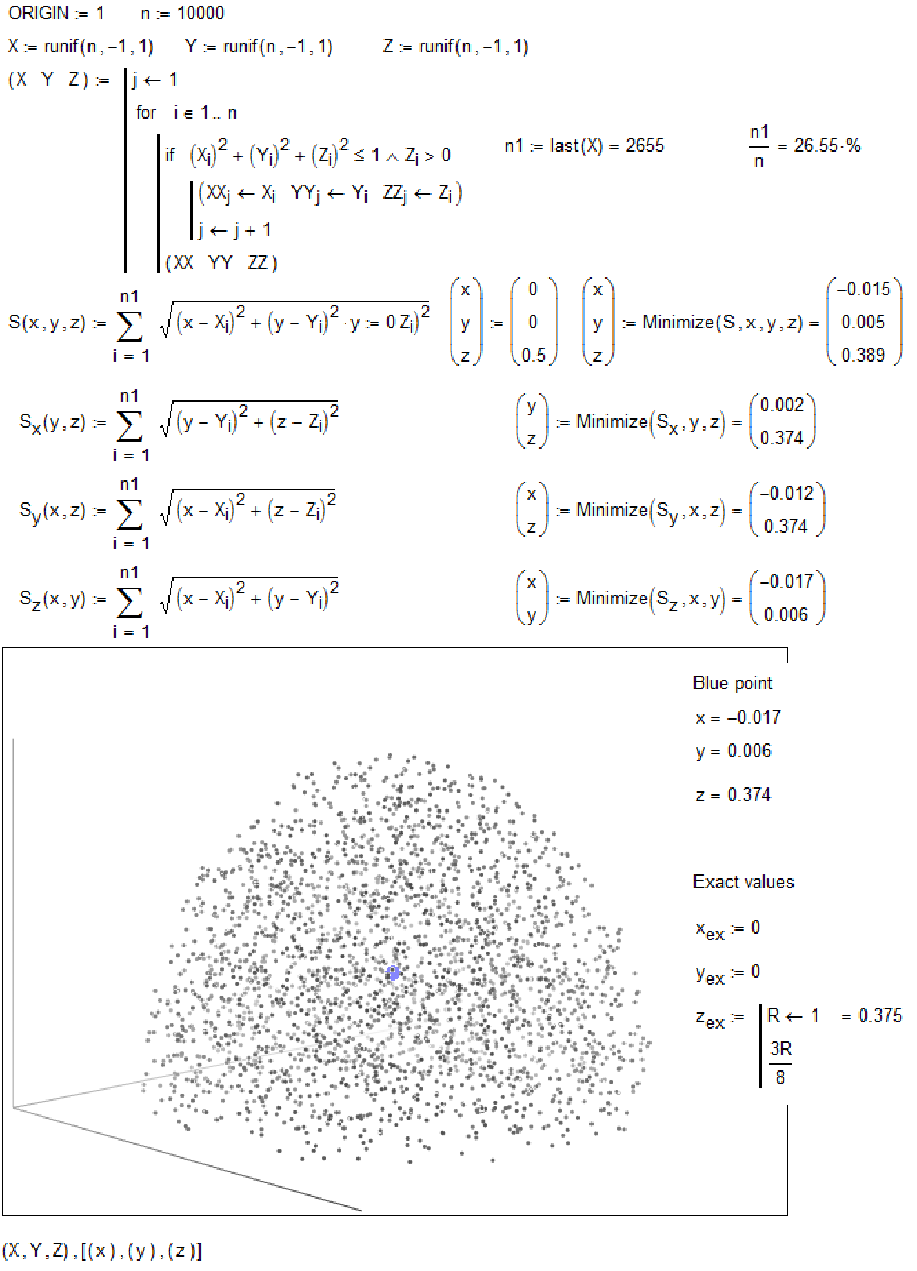

I think the geometric median and the center of gravity must be one point .
Why?
See please two method of the searching this point:

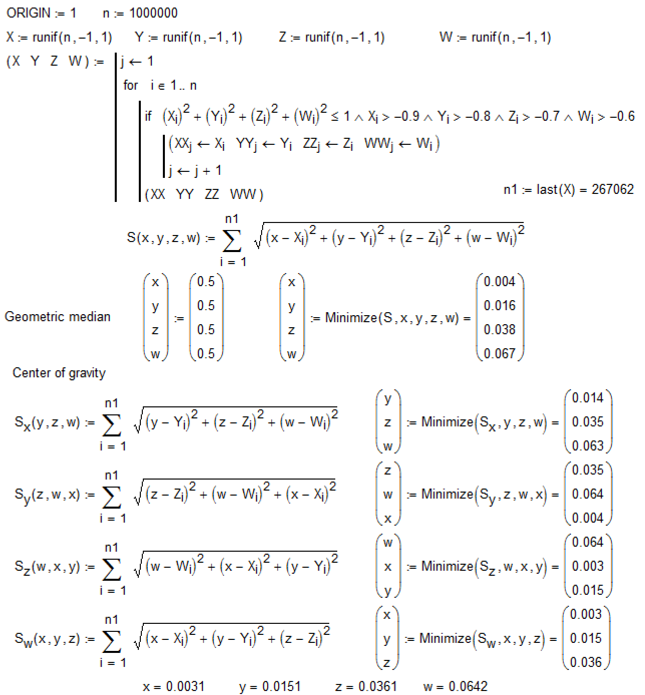

But we have by using our (Monte-Carlo) method;
April 4, 2017

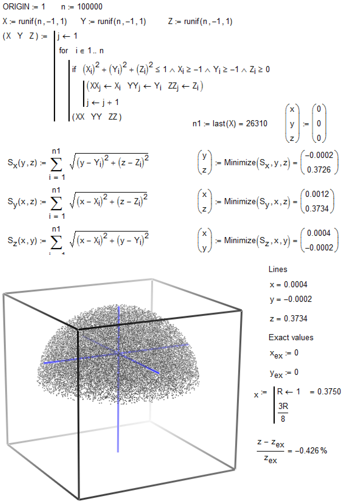

Center of Gravity... 4D-body
April 5, 2017
Two pictures and sheets for thinking!
Three points! Why?
One point!
April 6, 2017

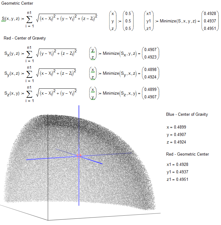

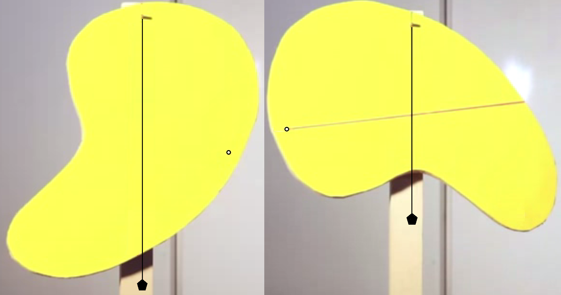

Mark and all!

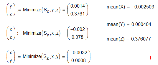

Is this correct center of gravity 3D body?
23-Emerald I
April 6, 2017

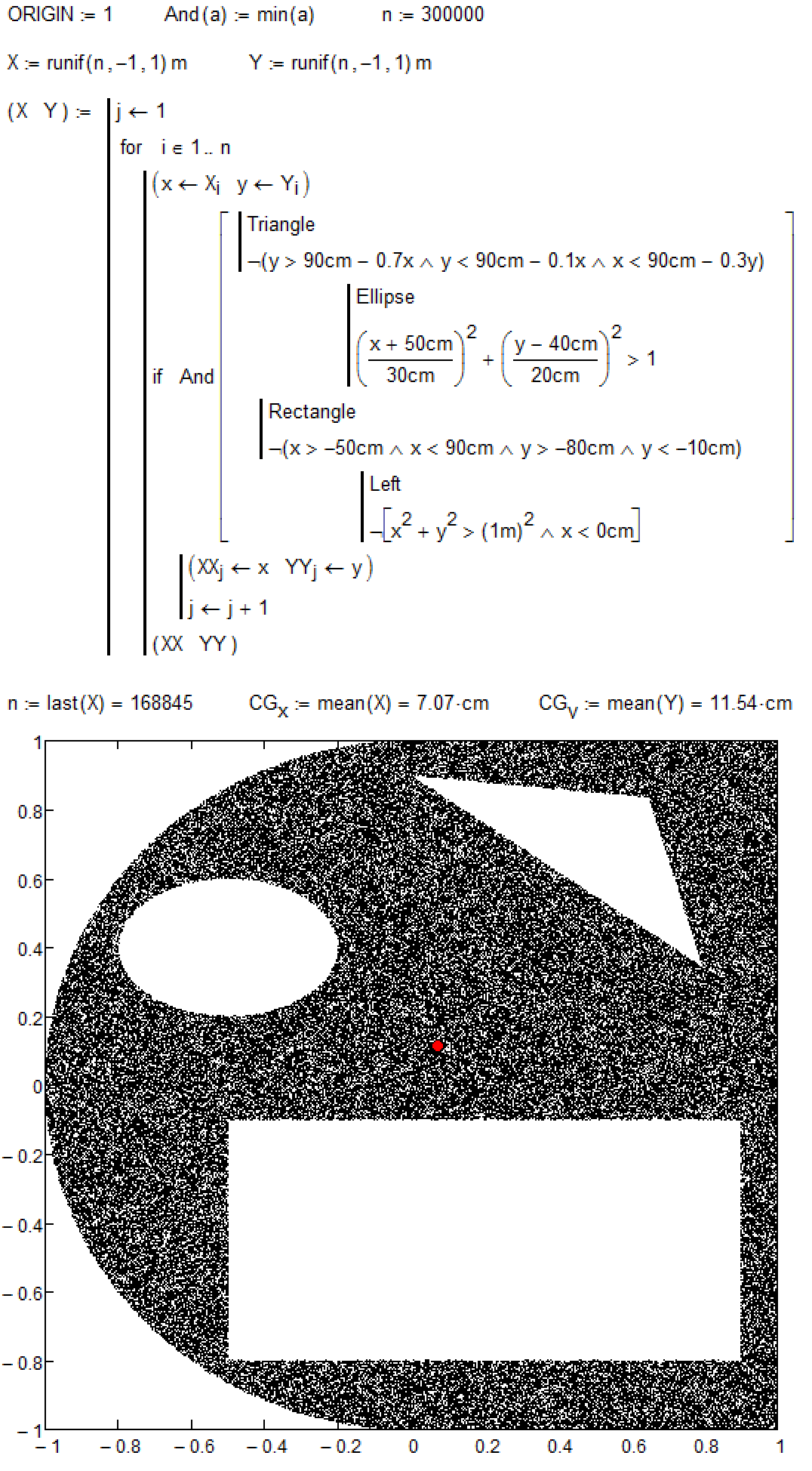

Yes, those are the coordinates of your CG.  But why are you working so hard?  The simple mean gives you more accurate answers:

Why so hard? We can calculate CG of plate with not constant density - one part is wood, the second - iron!
April 8, 2017
One more example
April 9, 2017
Our method of searching the center of gravity (mass) has a name Pointillism - Wikipedia
