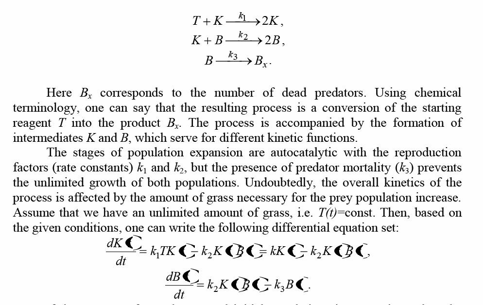

for the pdf version, most of the equations cannot be displayed properly on my computer. the word version is good
there are some Russian words in fig.3.1
September 9, 2010
As with the other poster, Word appears to display correctly, while the PDF has a mix of correct display and bad display. For whatever reason, every usage of "C" in an equation results in something that vague resembles a "C"

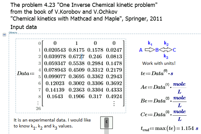

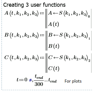

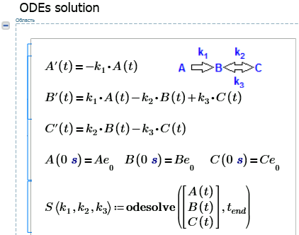

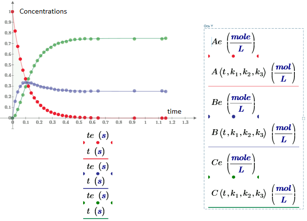

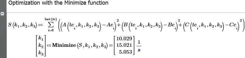

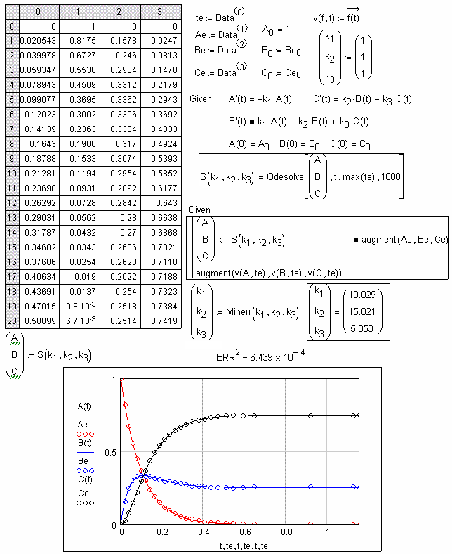

January 4, 2014

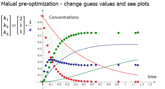

We would like to prepere this book for new edition - with Mathcad Prime.
See how fine (with units!) we solve one problem in Prime 3:
With Mathcad 14 (in old book):
