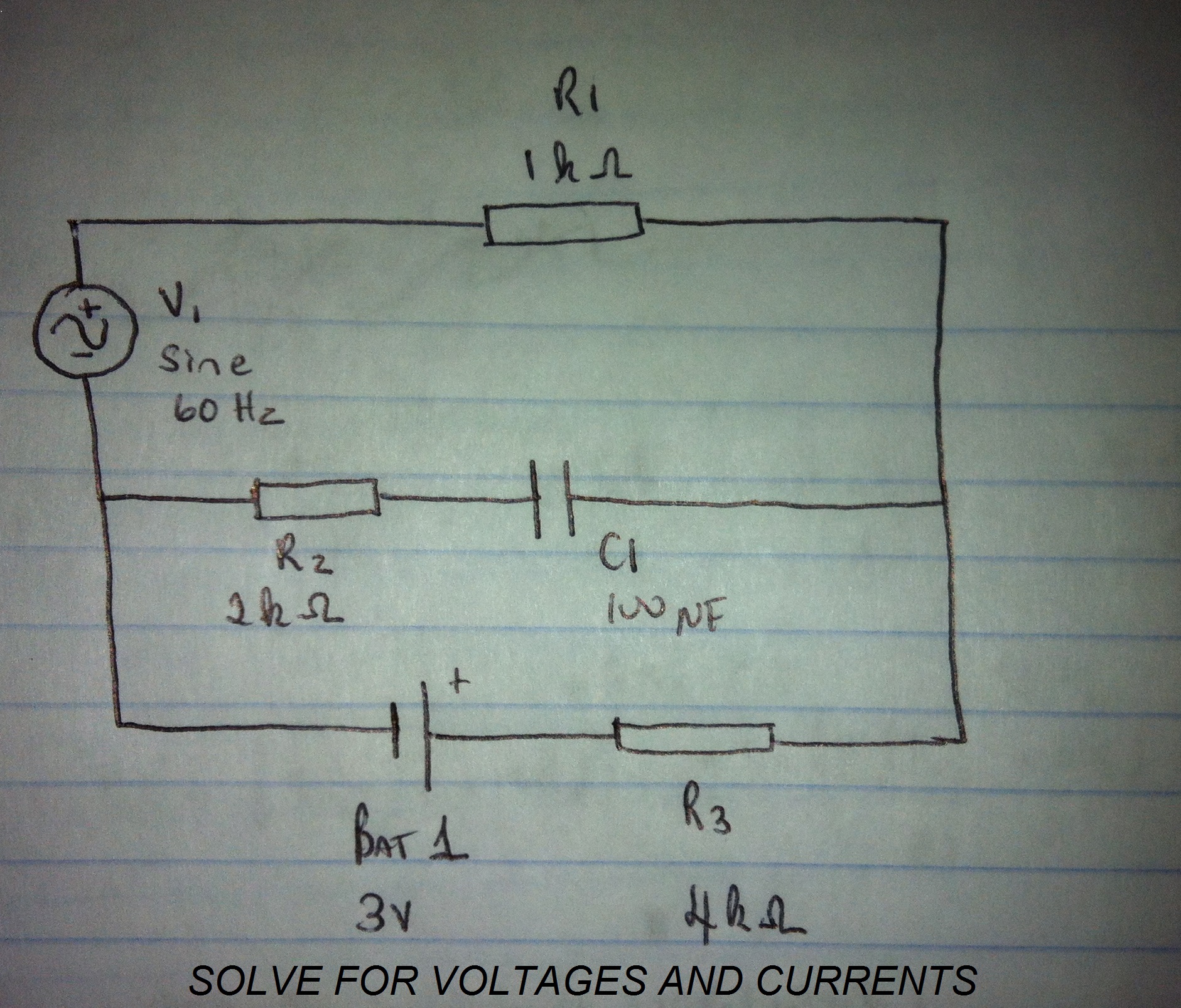

Is it possible to solve this with odesolve or statespace?

Not sure of the initial condtions or if the equations are incorrect.
23-Emerald I
November 5, 2013
Might be nice to explain what q1 and q2 are. If q is charge, there's only one charge holding device in your circuit.
And the amplitude of your 60 Hz? One? Really?

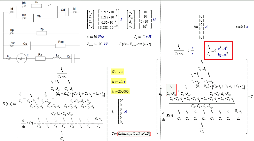

Couple years ago i have done something similar, please find attached. I deleted coments, thay were in russian.
I hope it will help You.
Regards
Andrii

Why? Russian here is a second language after English.
And more.
It is a task for Prime with full units in matrix.
Sorry Prime points an error in your model:

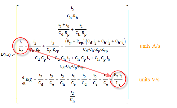

Its a fine thing to be able to use units here, otherwise the error would have been hard to spot. Wish we had that in MC15, too.
I'm too lazy to add the units but there seems to be a unit mismatch in the last but one line, too.
It looks like two expressions should be switched:
