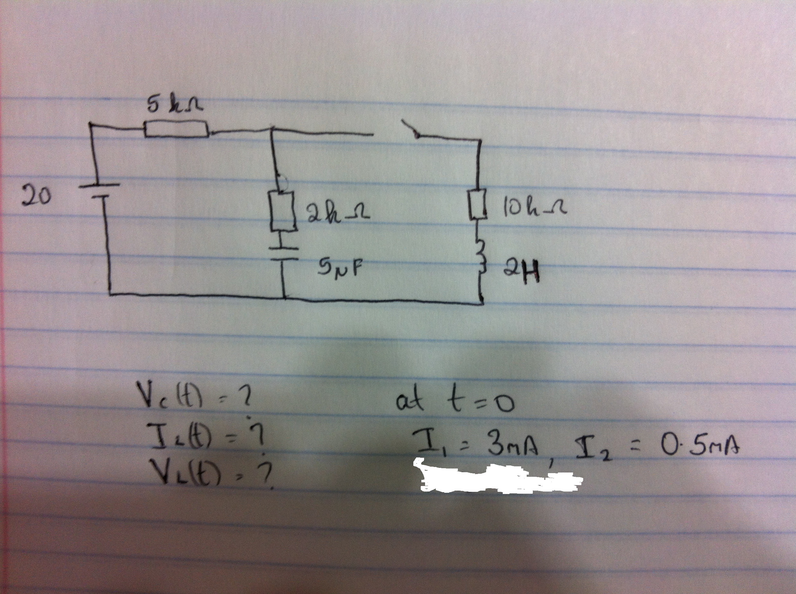

I'm not exactly sure what is causing the error of if I'm doing something completely wrong

I am a bit confused about the initial conditions. As I see it both currents I1 and I2 would be zero for t=0 (which obviously should denote the close of the switch.

Assuming that the capacitor is fully discharged (Vc= 0) I think that it is possible to achieve 3mA load on the voltage source. this csn be split to initial currents of 2.5mA into the capacitor & 0.5mA into the inductor or just 3mA int the capacitor & 0 into the inductor.
This doesn't match with the schematic drawn, the cap here will be fully charged to 20V long before you can close the switch.

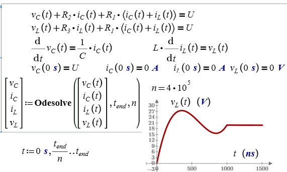

There were a bunch of errors in your file which could have been easily avoided by using, reading and paying attention to Mathcads help files!
  • As Valery pointed out you did not use the derivation operator in the second equation but simply typed a similar looking fraction
  • for initial values you must use the prime character, not the derivation operator
  • q1 would be first, q2 second order. So you need just three initial conditions, not six, as you try to provide.
  • you used the Odesolve command the wrong way. As you had set up a system of ODEs with two functions, the first parameter of Odesolve() has to be a vector with the names of those functions.
  • The result of Odesolve will be two (pseudo) functions, so on the LHS of the assignment you should provide an apropriate vector.

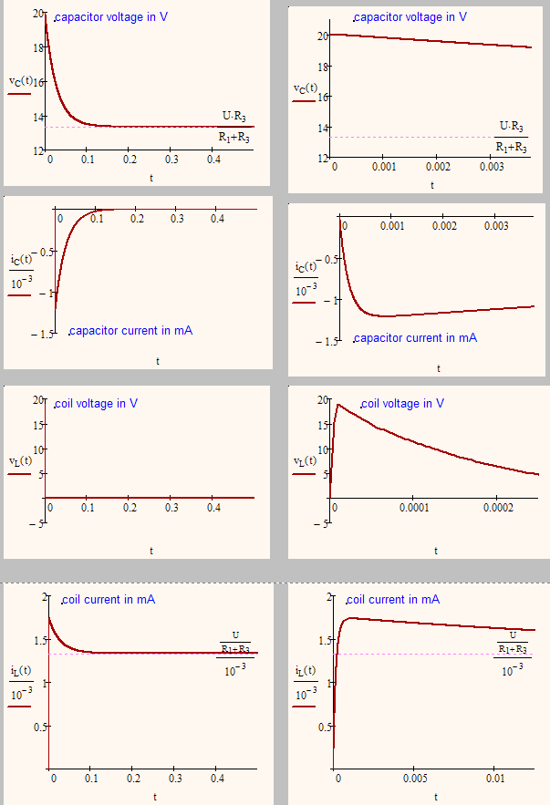

Furthermore, as was already stated, your initial conditions are definitely wrong, if we assume that t=0 would be the moment the switch is closed. All currents would be zero at that moment and the capacitor voltage could be assumed to be 20 V.
I also think that t=1 as endpoint is too big. After one second you will not see any more noticeable changes in your curcuit.
Nonetheless, Odesolve can be a stubborn beast and may be very sensible about the way you write your equations, So I have provided a solution to your problem but I followed a slightly different way in setting up the equations and throw overboard the charge functions. It seemed to me that you don't need them and their sole purpose was to get rid of the integral you get for the cap voltage.

Fine work, Werner! I done someone for hydro circuits
I repeate it is a task for Prime.
But we can use pseudounits in M15 - see please the attach
