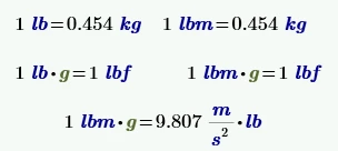

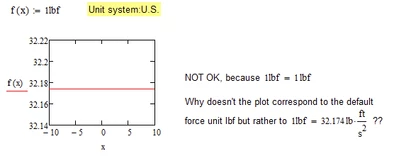

if you try to plot force in units of lbf by switching the unit system to US, the program plots Force*gravity instead. if you take what mathcad plots and divide by g, then it will show force in units of lbf.
the trick i found on here was to just use the metric system and divide force by lbf. that works good. so i'll use this going forward. however, this seems like a bug when trying to use the built in US unit system. the program outputs any force variable in lbf. it just plots that variable in lbf * g instead of plotting lbf.

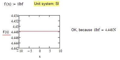

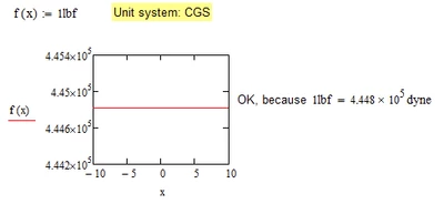

    To further clarify:
    I still tend to call this a bug (which is not present in Prime)

    i figured i should post this to see if anyone else has noticed it. it doesn't seem right. i tried creating a custom unit system (based off the US system) and it just made things even weirder. you can't control the force output with mathcad. it just allows it's built in types. but if you change length and time then the plot output for force is even more messed up. it takes your length and time into account and also multiplies by gravity. so the bug aspect is in the unit definition it says pound force. it will display that for a variable but not in the plot. the other aspect of the bug is this is only for the built in US system or a customization of it. the metric systems don't have this behavior.
    so using the help from the old post, i can get what i want. which was velocity as the x axis in mph and force in lbf for the y axis. i leave the program in SI units. then plot F/lbf and v/mph. then the output of the plot is what i want.

    Dividing a physical quantity by the unit you'd like to see in the plot is standard behaviour in classic Mathcad (and is independent from the unit system selected).
    Nonetheless is the effect you describe somewhat strange and I also tend to call it a bug.

    no i'm afraid the issue is different. it has to do with the magnitude of force in a plot. the built in unit system says pound force is the output. however it plots lbf * g. if you make a custom unit with 'US' as the starting system, it does the same thing. even worse, if you change the units of distance and time it also adds that in. so the magnitude of the force that is plotted can be really messed up. it definitely seems to be a bug, as this doesn't happen if you use any of the metric systems. moreover, it doesn't plot N * g.
