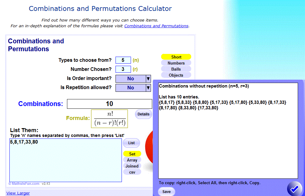

I am trying to write a program but it did not work out. Actually, I do not know the programming in Mathcad. Black magic for me.
I want to have the program written in Mathcad because I would have to export a file from the Internet websites and later imported into Mathcad. Too much of this work.
Example of what I want to get on this page:http://www.mathsisfun.com/combinatorics/combinations-permutations-calculator.html
Please see the attached file for more info. Thanks! JK

I'm sorry but this is not the solution to my problem....
see a *.gif file.
I have a vector(array) of numbers:
Vec:=[5,8,17,33,80]
and I would like to enumerate all the combinations of a subset of three of element.
The result is:
5,8,17
5,8,33
5,8,80
17,33,80
Total to be 10.
Of course, I also want the program to solve various possibilities depending on the vector(array).
An example:
Vec:=[20,31,41,45,65,78,80] to subset of 4 of element.
result is:
20,31,41,45
20,31,41,65
20,31,41,78
45,65,78,80
Combin(7,4)=35 possibilities

Something like the attached?
Still playing lotto?
jkowalski1-VisitorAuthor
January 18, 2013
This worked perfectly well. 🙂
