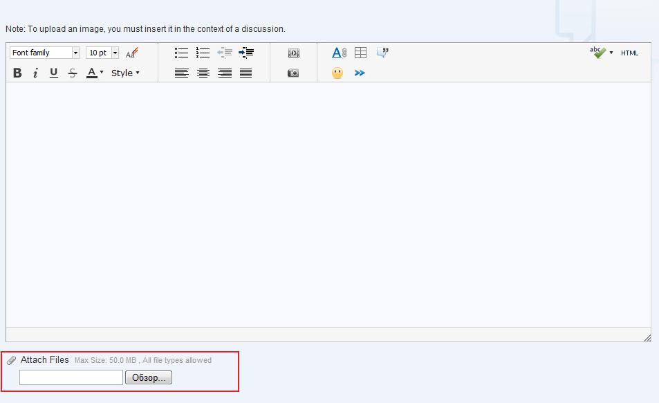

Here's a tip how to attach a file:
1. Step
2. Step

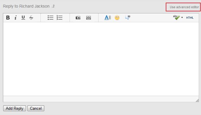

when i am replying to you, how could i attach the mathcadsheet?
October 12, 2011
At the top right it says "Use advanced Editor". Click on that, then you will be able to attach files.
The advanced editor used to be the default. I don't know why they changed it.
