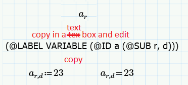

Best answer by ValeryOchkov
Robert Frost wrote:
I am trying to base my calculations around eurocodes which uses a lot of subscript notations to define things, including commas i.e. Nt,Rd where t,Rd should be subscript. However I can only seem to put one continous list of characters subscripted and no commas when defining a variable in Mathcad. Is there a way of doing this? (I am usimg Mathcad Prime 2.0)
Thanks in advance,
Rob
Try this please in Prime 2
A space we cannot so insert a variable name

Another way of doing it in Prime would be using the matrix index - nevertheless i wouldn't recommend doing so.
Define t and rd to be zero (maybe in a collapsible area) and create N as a 1x1 matrix:
Thanks in advance,
Rob
May 14, 2013
Thanks! I wasn't aware of that possibility. Works like a charm!
And you are right, neither [space] nor Alt-2-5-5 will have any effect.
May 15, 2013
You welcome!
"There are more things in heaven and earth, Horatio,
Than are dreamt of in your philosophy."
It was a rule in the Soviet era - do not get used to Delicatessen - soon it will become scarce
This trick not work in Mathcad Prime 3 with an inserting Math area into Text area.
But we can create kJ/(kg K) etc in Prime 2 and use in Prime 3 and... new tricks
