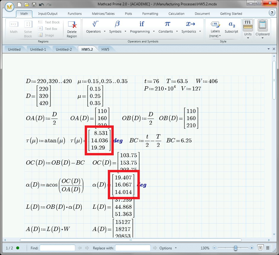

So I'm very new to mathcad prime and I'm trying to compare resultant numbers from computing with range variables. I was hoping someone could show me how to figure out what I'm trying to accomplish.
Example (simplified):
I've defined two range variables
A:=220,320..420
B:=840,640...440
then applying some math with the RVs
C(A):=A/2
D(B):=B/4
I would then like to compare the first value of C to the three values in D and determine if it is greater than or less then the D value and then output an array with Yes if greater, or No is less than. Then repeat this with the second and third values in C respectively.
I'm thing something like this...
i=0
j=0
for i=1:3
for j=1:3
if C(i)>D(j)
E(i+j) = "Yes" %I'd like the ouput to be a one dimensional array/vector and not a two dimensional matrix
else
E(i+j) = "No"
end
end
The red boxes are the two variables I'd like to compare, and display if alpha is greater than tau in a coulmn matrix/array.

The attached should help. Be careful to learn the difference between range variables and "proper" variables.
Alan
March 7, 2013
Would you be so kind as to briefly describe the difference?
March 7, 2013
See the attached articles by Stuart Bruff.
