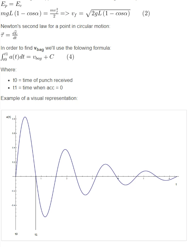

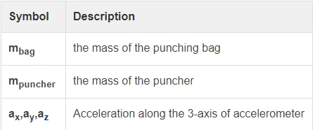

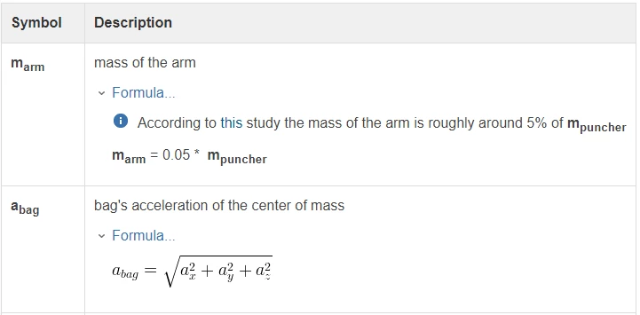

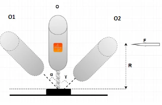

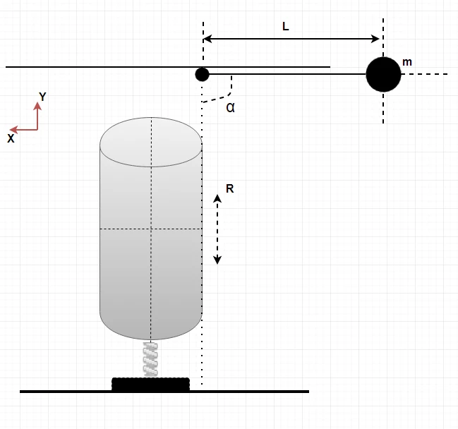

Hello!
About a week ago I've received the following problem:
You have a ground fixed punch bag (resting on a spring that's attached to a counterweight).
What is the minimum sensor setup in order to determine:
- the force of the punch in the bag
- acceleration of the punch
- the speed of the punches (for multiple punches)
Notes:
- no sensor must be attached to the person punching the bag, only on the bag
- bag is punched in a limited vertical area
Justify the answer with:
- sensors
- calculations
Working as hardware engineer, I must admit I'm not that experienced with physics.
I've been trying to figure a way to solve it for a week now. What I thought of is mounting an IMU in the center of the bag and after that gather experimental data by hitting the bag with a pendulum. What's hard for me to determine is the force with which the bag is hit, how much of that force gets absorbed by the padding and the remaining force that drives the bag afterwards. Finding the acceleration and speed of the much would be pretty easy after finding the force, by applying Newton's second law.
Any help would be highly appreciated!
Check attachments section for some visuals on the problem.
