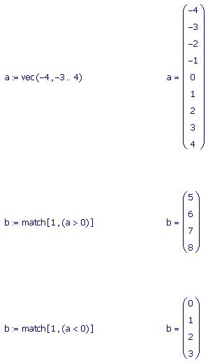

is it possible in one line to extract a sub-vector of all elements in another vector which satisfy some rule e.g. all elements > 0 for example?
I know how to do it in a programming loop but if there is a built in method then it's likely to be more efficient.
I can do it easily in matlab like:
z = x(x>0)
D
Best answer by RichardJ
When I look at it, that does not work. You need lookup, not match.
Attached in version 11 and version 6 (as far back as I can go) formats.

Hi thanks for that, however I'm on an old student version of Mathcad (OU study). Any chance you could post plain text?
Many thanks,
D
June 30, 2011
Sorry for the delay upon responding I have been out training.
See below.
Mike
