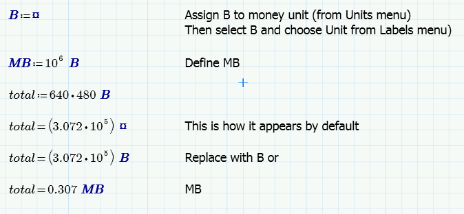

You can set B:=1 and MB:= 10^6 B and label them as Unit from Labels menu. However, the unit does not 'stick' this way.
If you aren't interested in the money unit you can do the following:
This way the unit 'sticks' but you still have to change it to look like B or MB by hand.
Alan

Or
kB=1024B (2^10)
MB=2^20B etc
