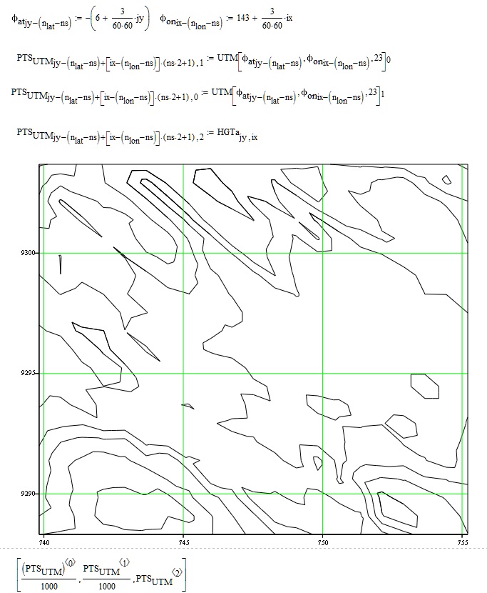

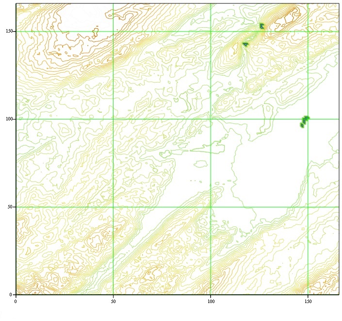

That is how this GIS northing and easting contour map is put up the right way with north up the page.
Real data from Shuttle Radar Topography Mission. Converted to easting northings from several tiles that meet on this map and then adjusted to put north up the page. Cut and Pasted as a graphic. This one it is the indexes into the dataset that is reversed. This way it simply plots the proper way round.
April 28, 2014
Pedro,
The indexing of the three columns used as the input to the contour plot is the trick
UTM(a,b) is a function that calcs the relevant E/N in UTM.
