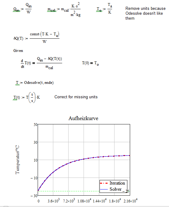

Hello folks,
I have here a worksheet (MC15 on a 64 bit Win 7 machine) in which I tried to achieve by a solve block what I have done with an iteration. It is a plain heat transfer problem for which I try to compute the gas temperature in a confined volume.
Problem is that the Find function works like a charm but delivers a wrong answer; the solver finds a linear temperature increase wheas my iteration shows a saturation effect. I suspect that I have stated the conditions wrong.
Does anybody have the time at hands to check what's wrong?

Best answer by AlanStevens
Why not just use Odesolve?
Alan
December 2, 2013
Alan

Thank you Alan. You made my day!

No problem! Perhaps I should also point out that there is an analytical solution to the ode:
