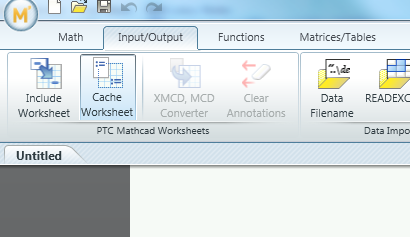

Trying to import an .xmct template into Mathcad Prime 3 I got stuck because the xmcd button is grayed out.
It seems that I need a copy of Mathcad 15 to access that functionality.
Is there a way I can convert that template without the need of installing the old program version?
Thank you for your suggestions.
Chris
Best answer by Werner_E
Here is the converted file. Guess it will need at least some reformatting.
January 7, 2014
Its true, you need a full install of Mathcad 15 to be able to convert leagcy sheets.
Another way is is to post the sheet here (if you can do that) and ask if someone can do it for you.
Because Prime lacks a lot of the features Mathcad 15 has, the conversion will work fine for very basic sheets only.
January 7, 2014
Werner, thanks for the clarification.
I'll give it a try with posting the file.
Can anybody give it a try?
Chris
Werner_E25-Diamond IAnswer
January 7, 2014
