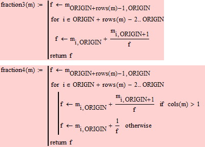

OK, here you are:
fraction3 was the first attempt and only works with two column matrices while fraction4 should work with both.
Again no errorhandling - use at your own risk 😉
See attached worksheet.

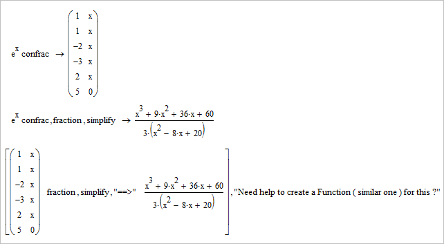

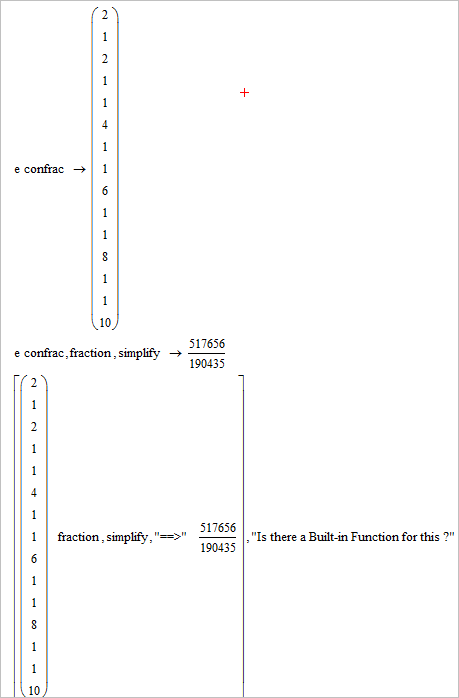

fraction is sort of a modifier for confrac and I don't think that there is a built in function which does what you want. But it's not hard to write your own - see attached file.
WR

Many thanks for the following function, Winfrod.
-LL-

Hello again,
My original question was answered. I have a related question:
Best Regards,
Loi Le.
