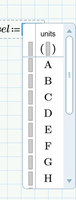

How do I copy paste large data in first column of combo box? Rest columns I am able to copy paste the data but first column how to do that?

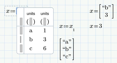

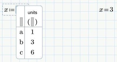

Here an example.
Instead of
you may use
The index 1 used is only valid if ORIGIN is at its default value 0. You may use "ORIGIN+1" instead of "1" to be on the safe side.
The first data column (a,b,c) was created using copy& paste with the vector of strings you see in the picture.

Here an example.
Instead of
you may use
