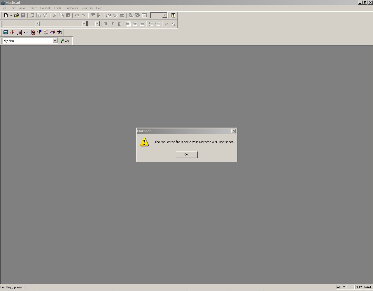

Corrupted Mathcad File
It seems that I have a corrupted mathcad file. I get the following error message when I try to open it. I am using version 15. Is there a way to fix this, I've attached the file.
Jun 27, 2013 2:53 PM UTC
I have seen this error a few times myself.
It usually happens when mathcad crashes during a save.
If this is what happened then the file will be 0 bytes long (no content) & not recoverable from the file.
However, if you look in the folder where you were trying to save there may be a file in the form "MFCxxnn.TMP" where xx are random letters & nn are random digits.
If there is try renaming it from .tmp to .xmcd .
My experience has been that I can usually recover all the data that I had saved.

Jun 27, 2013 2:59 PM UTC
Looks like that's what happened, unfortunately no such tmp file, oh well, thanks for the help all.
Dec 17, 2013 1:05 PM UTC
I got the same problem here, I tried something with file recovery but I'm not sure how it works
can anyone help me ??
Problem should be in
line number: 3814
character position: 135

Dec 17, 2013 3:51 PM UTC
Hello Maarten,
Hopefully this is what you had.
The highlighted equation is the one that I think had failed, but there are a ery large numer of invalid equations (all showing red) so you will need to check through everything carefully.
