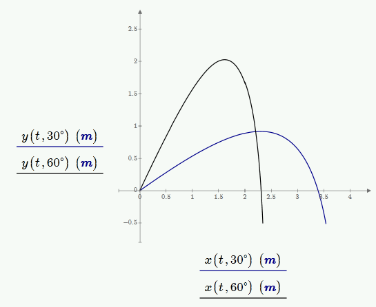

I try to create a user function as a ODEs solution for this task
http://communities.ptc.com/message/223872
I do not know how to do it with the odesolve function but I know how do it with the rkfixed function. But I do not remember how use rkfixed for this ODEs.
Help me please - the Mathcad Prime 3 sheet in attach.
Best answer by Werner_E

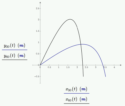

But why we cannot have x(t, alpha), y(t, alpha) etc for example by odesolve?
We can have what you demand, but its by no means advisable to do so because the whole Odesolveblock is evaluated again for every value of t.
That approach may be OK for calculationg selected values or smaller tables, but not for plotting as the solveblock would have to be evaluated twice for every point calculated.
But maybe this is the time to (again) add vectors of functions to our wishlist for Mathcad Prime 20.0.
Its far more efficient to create different functions for plotting.

May be so, but why I have an error - see te attach please - Prime 2.
December 4, 2013
Because you have used the local assignment operator (<--) instead of the "normal" (:=) one. That way Z() is not defined on the worksheet level.
December 4, 2013
Thanks, but see the attach.

Thanks, Alan, I know it.

Sorry, where is an arror in attach (MC 15) - in Prime all OK!
23-Emerald I
December 5, 2013
Your Reynold's Number is using density instead of viscosity. Fix that---it works!
December 5, 2013
and also change the sign before the gravity constant to make the water drops fall down 😉
