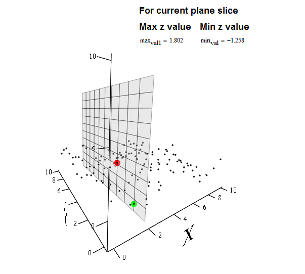

September 19, 2012
Hi Phillip,
Not sure I fully understand what you mean by a separating hyper-plane.
Below is something I put together to show cloud data (experimental) and how the data can be sliced at a particular plane to identify max/min values with a single scatter data set.
I can share the worksheet (v14/15) if its close to what you require.
Best regards,
Thomas

October 15, 2012
Hi Philip,
Here is the file.
I used some functions from the ebook "Creating Amazing Images with Mathcad 14" created by Byrge Birkeland.
There are a wealth of useful functions he has built in there.
You can find it here if interested http://communities.ptc.com/community/mathcad/mathcad-usage/blog/2010/05/27/creating-amazing-images-with-mathcad-14
Hope it helps.
Thomas
